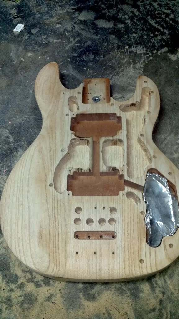

I've got a great condition 1979 t40. (I put pics in the photo section) I love the way it sounds, but not the way it makes my middle age body feel after a 3 hour gig. A few years ago I picked up an extra body for it. Not great condition, just an old body with some scarring on it.
Here's my idea, I'd decided to cut a forearm contour into the topside, and tummy cut into the back. I also routed out some of the extra material under the pickguard.
Right now it's almost 5 pounds just for the body by itself. Every little bit helps, and if I can put together a T40 that is around 10 pounds, I'll be happy. the one I play now is a little over 12, but I think the extra body isn't as heavy a wood as the good condition one. I'll weigh it after I get it apart
I'll still leave my nice body alone, only experimenting on the junk body I have. that way if I decide to sell it someday, I can leave it up to the new owner which way he would like it.
I'm also going to do a sunburst finish on the new body when I'm done sanding it.

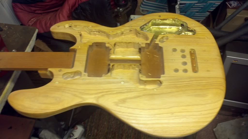

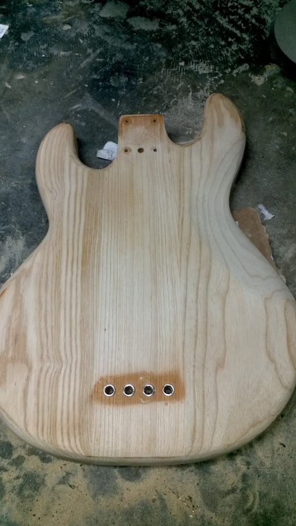

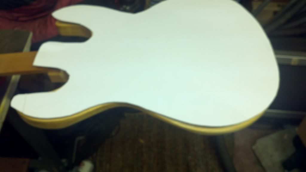

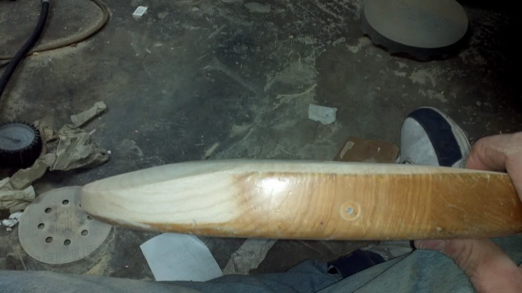

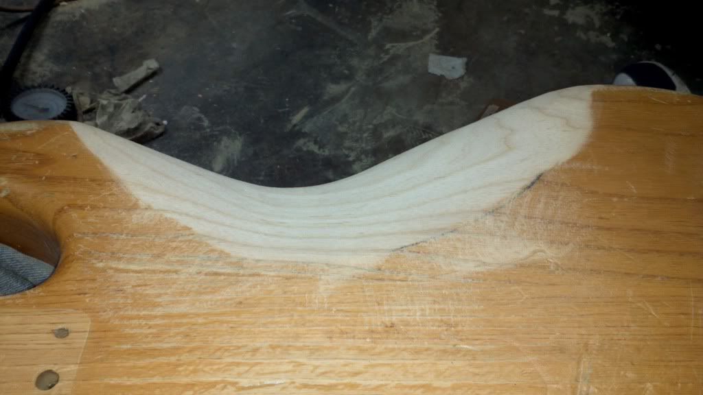

here's pics of the progress so far
So far the bass is about a pound lighter. I was hoping for a little more, but it helps.

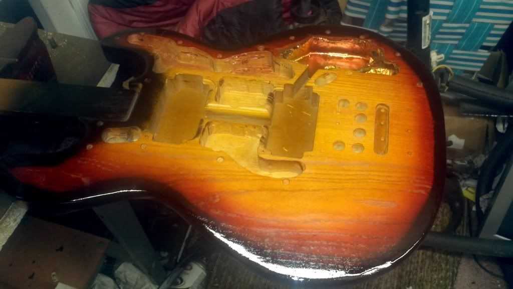

new progress!
I sanded it down smooth, put in grain filler. Sanded lightly
then I used a little amber tinted clear as a sealer. why amber? because I then sanded it down again, and the color contrast between the amber and the wood grain showed me where it wasn't totally smooth
then I re sealed it, and got it ready to spray the black edge
mask in place
the black is sprayed already, but I didn't take pics yet. I will tonight

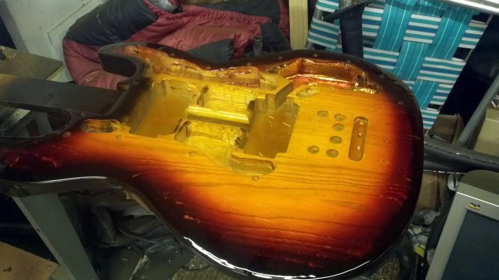

here's the latest
I'm not happy with the transition from the black to the red/brown. I'm going to keep adding the brown until I get a better graduation between the two

PostSubject: Re: modding my t-40   Wed Jan 11, 2012 7:39 pm
this is after the first coat of clear. I'm hoping to get 12-15 total coats to make s good foundation for sanding and buffing
don't worry, I'm not going to take a photo after every coat, LOL

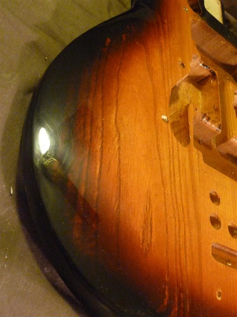

PostSubject: Re: modding my t-40   Sun Jan 22, 2012 8:42 pm
sanded the lacquer down, and then used 3m super duty rubbing compound on it, followed by maguires show car glaze. there's still some squirl marks I'd rather not have, so I'm going to try something else to get them out
but you have to hold the bass in a certain light to see them, from 12 inches away this thing looks great, if I do say so myself

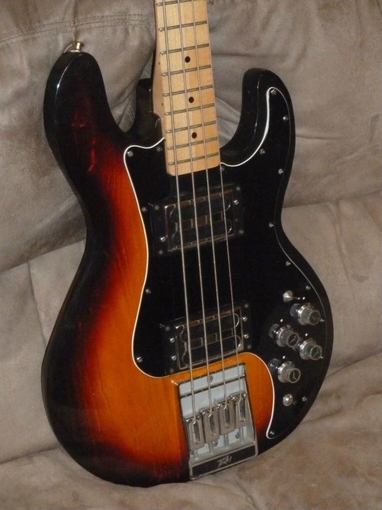

PostSubject: Re: modding my t-40   Sun Jan 29, 2012 3:39 pm
DONE!
plays great, better than before because I messed with the neck tilt while I put back together.

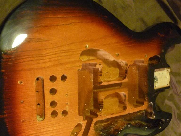

and the weight? this is very interesting...
This body was 5.2lbs when I started, an I got it down to 4.2. I just weighed the old body by itself, and it said 6.4! so I saved over a pound just by switching bodies. Between the lighter body and the routing that I did, the new bass is...
9.6 lbs!!!
that's about a 3 pound loss, which I don't really understand because I thought I only lost a pound because of the routing, but three pounds lighter is HUGE
I was hoping for a little less than 10, so this project has been so worth it. I'm thrilled
