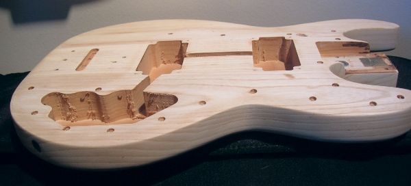

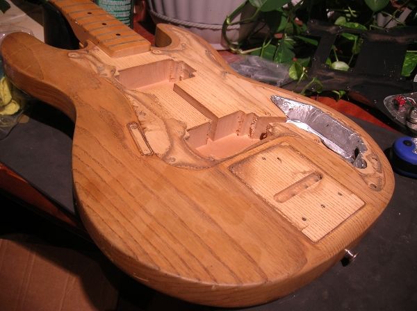

I finally started the process of stripping down my '78 T-40.  I was going against advice not to mess with the "mojo"or originality of the very worn finish.  In fact, there virtually WAS no finish on the front, and the back was badly checked.
Imagine my surprise when I removed the pickguard only to find RAW WOOD underneath!  Upon further examination, there was NO FINISH under the bridge, either!  The final telling point was when I removed the non-stock thumbrest which was mounted on the bass side of the pickguard.  This, too had raw wood underneath.
Thanks to Frank N. Peavey on this board, I found out that at no time did Peavey leave these sections unfinished, so I now know that my T-40 has been stripped and refinished in the past.  And not too well, if they assembled the bridge and pickguard BEFORE putting the clearcoat on!
So I now relieved to know that I am not messing up by removing an original finish.  As a service to others, I'm posting pictures of what my T-40 body looks like without all the hardware.  If yours looks anything like this, it's not original either!

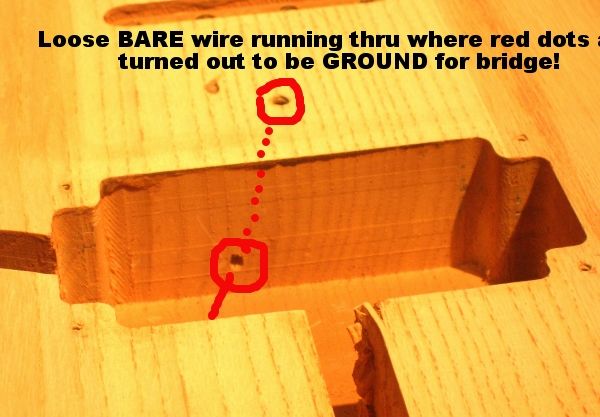

If anyone wants to see other pictures of the T-40 stripped down (pickups, back of control plate, pots, switches, etc.), PM me or send me an email, and I'll be happy to post some up!

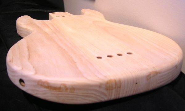

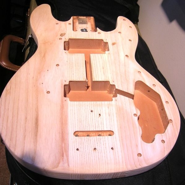

Well, I haven't made a whole lot of progress.  I did, however, strip the body down to good virgin ash with successive grits of sandpaper.  I'm at 220 now, and will probably hit it lightly one more time with 320 grit, then move on.
My quandry is whether to use a light honey stain (to match the neck tint) FIRST, and then hit the grain with a slightly darker grain filler, or to use the FILLER first, and then stain?  Calls for more online study, I guess!
Anyway, here's a few pics of the body sanded down (I'm so glad most of the "finish" was gone....I didn't have to use any chemical strippers!).

Great photos Mike. You might want to work on the stains at the bottom edge of body, they will definitely show up
later. My experience (restoring antique furniture) has shown that you should fill the grain with your dark stain
first (make sure it is thoroughly dried) then sand off with a 600 grit then apply your lighter stain. The finer the
grit used will help improve the final sprayed smooth finish. Last step should be to polish with Rottenstone
powder & mineral oil on a felt polishing block, it will look incredible, unless you are using a satin finish then that
won't be necessary. If that is the case you could use hand rubbed Tung oil,good stuff.
Keep us updated on your progress.
Brad.
