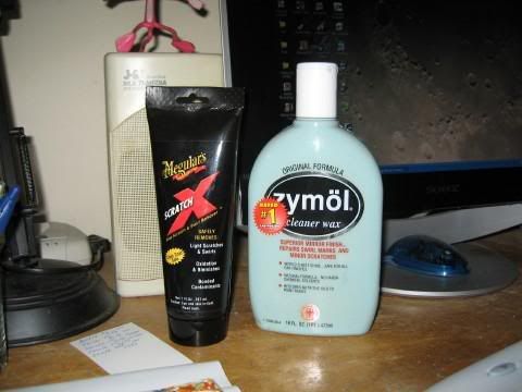

I wrote about this in a previous thread. So, I'll copy/paste here. This application looks exceptionally good on dark colors. It will absolutely bring that black back to life!!!
Ok, as for cleaning and polishing I first use a product called Scratch-X. I buy some 100% cotton cloth diapers from Wal-Mart and start with about a dime size of product on the diaper and just work it into the finish. Don't let it sit on the finish, just work it in and wipe with a clean cloth. I'll do the entire instrument with that, including the fretboard. The fretboard on the T-40 I just bought was nasty. I removed the strings and really got into cleaning the fretboard. Took about an hour.
After the Scratch-X, I use a cleaner wax called Zymol. Both products can be found in any good Car Care store. Zymol comes in many different formulas, the one I use is a light bluish color and states "Original Formula". This product gives a super mirror like gloss. Do not use this on unfinished wood like rosewood fretboards. I'll do the same routine as with the Scratch-X, small amount on a cloth diaper working it into the finish and wiping clean. You will not believe the results especially on solid color finishes like black and red. It's ok to use these on natural finish T-40's, it has a sealer finish already on the wood. Using 3-4 coats of Zymol is optimum.
These products are made to clean and buff out small surface scratches and swirls, also to produce a beautiful mirror like finish. Hope this helps. If you buy these you won't be disappointed.
I use boiled linseed oil to clean rosewood fretboards. I have never had a problem with it drying out wood.
I hope this helps.

I would think these products are available over there. Here's what you want to get:
[img]
