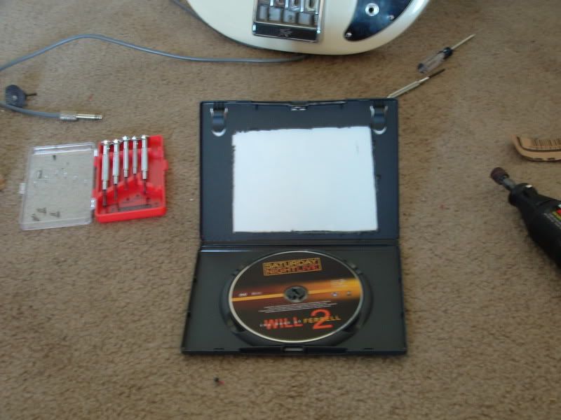

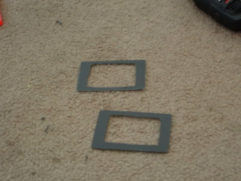

Not satisfied with the gaps on the sides of the pickups, I made these: (rough form)
From this:
And the end result is this:
